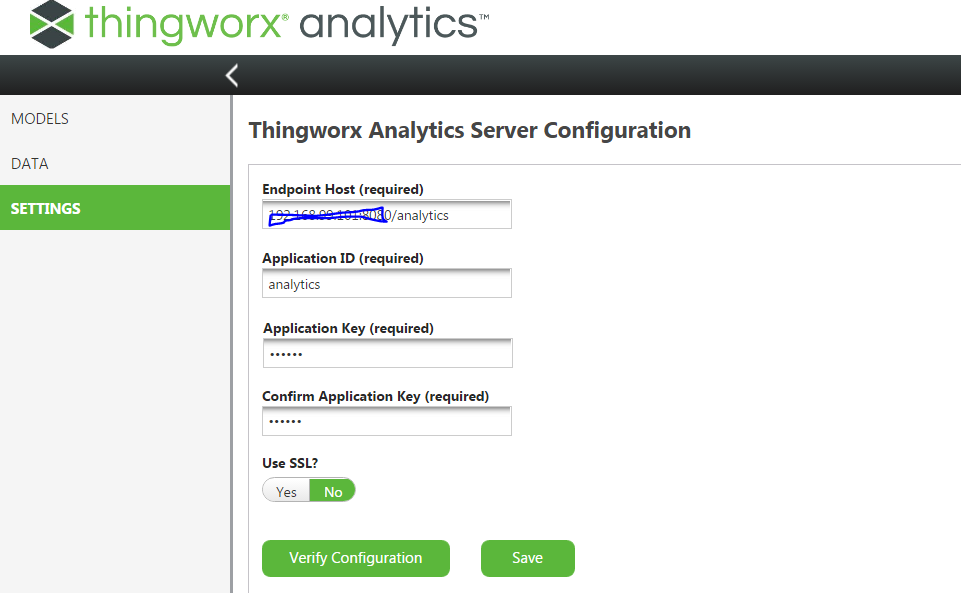

Following the steps of the Analytics Builder Quickstart, I reach the point where the Analytic Server must be identified.
I set the IP for the local Analytic Server and I set "neuronuser" as Application Id. When I execute "Verify Configuration", the next message appears on the top of the screen:
Error invoking service: Invalid Analytics Server Version (ValidateMLServerVersion#5)
I have installed Analytics Server 7.4, and I'm using Thingworx 7.4.
Could anyone give me any clue about this issue?
Thank you very much

DAVID ALGUACIL​:
Could you please confirm if you analytic server is up and running as the error message you received comes when server is down.
Try updating application id as analytics.
Please ensure ​Endpoint host contains <IP>:<PORT>/analytics

Hi
you mentioned using ThingWorx Analytics server 7.4 with ThingWorx 7.4.
Could you also specify the version of the ThingWorx Analytics extension you have, as seen in Import/Export > Manage ?
Also for the endpoint Host, you should have <host>:<port> , you seem to indicate to have entered only the ip address.
You can check this video at time 25 sec: Video Link : 1676, to compare the Settings.
The /analytics mentioned by Mohit is something that needs to be added if using ThingWorx analytics 8.0 but that does not seem to be your case.
Christophe

Thank you for your answers.
The problem is that services are not started in the VM. This morning I have repeat the procedure and everything seems to be OK. However, if I run the command "service --status-all", there is no services running. I expected to see Zookeeper, PostgreSQL Server, GridWorker and Tomcat services (as it specified in Troubleshooting Steps for ThingWorx Analytics: Restarting Services Manually, or full Graceful Restart of Application
In fact, when I try to access to the Analytics Server from any web browser, it is not accessible.If I run a ping command to the VM, there is good reply.

Finally I could solve the problem.
When I installed the Analytic Server, I changed the Network configuration to be accessible in the local network. For some reason, it induced a problem during the virtual machine start up and the services were not started.
Now, I have the virtual machine network adapted configured as Bridge with a IP valid for the local network. With this, I have access to the Analytics Server from any computer in the local network.
I have restarted the tutorial and I have configured the Thingworx Analytics Server as both, Mohit and Christophe, told me, using the IP:PORT.
Now everything is working.
