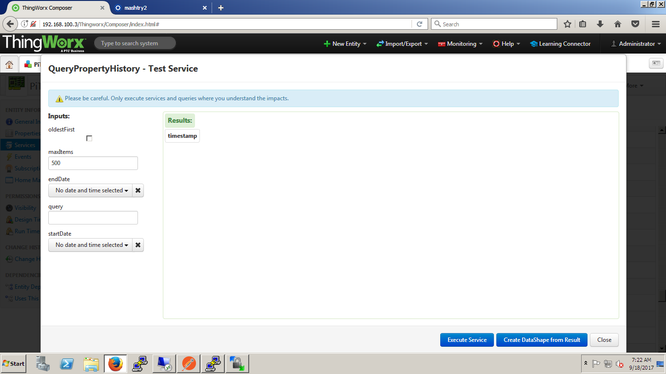

I have done with Raspberry pi Quick start guide using EMS, now i want to Store those readings in Value stream, if i create a value stream and assign to the Thing,,
Generic services "QueryPropertyHistory" showing nothing Values instead just showing "Timestamp".
I also tried with Creating datashape,but no result..is it Possible to store values in "ValueStream" without creating "ThingTemplate",,,if so How???
Thank you!!

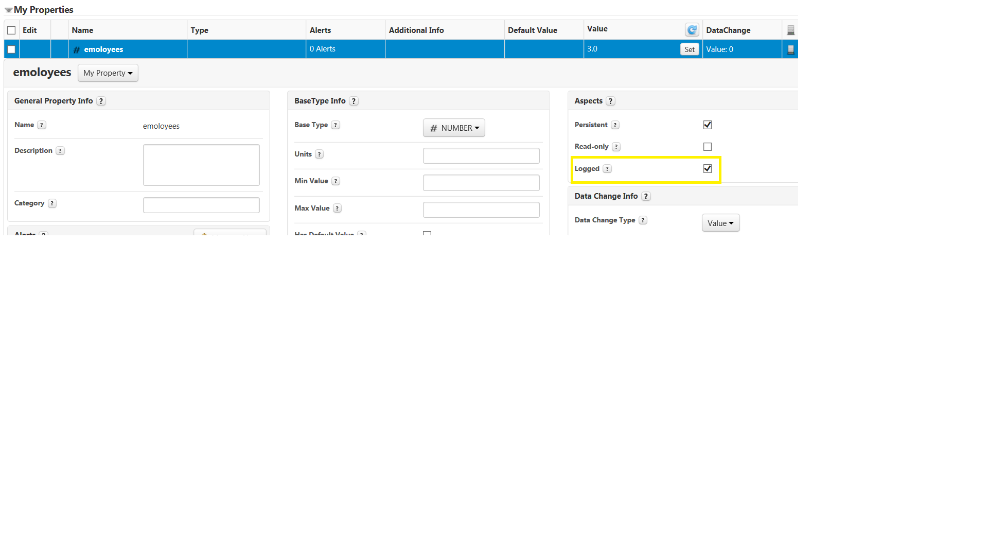

Hi Akshayakumar,
Did you check on logged for the property that you want to be logged in Value Stream?
September 18, 2017
Thank you soo much sir,
That was the issue.
now working properly
