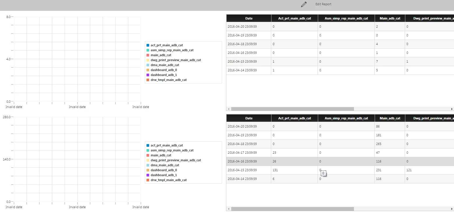

Hi all,
i read in this forum that time series chart can find the first date time column and put it as the x axis,
but for some reason it's doesn't do this trick for me., any ideas??
in the following example both the grid and the chart get the same inputtime series.png

    Amir, does the XAxisFormat setting on the TimeSeries Chart match the Timestamps you're providing it?
    aharari-21-VisitorAuthor
    April 26, 2016
    thanks for the answer aanjan,yes it is matched, maybe you have any other idea?

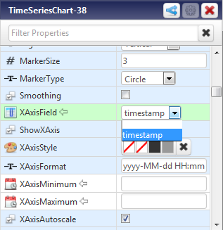

    April 26, 2016
    It would be helpful to see a screenshot of the property settings for the chart.
    Does the chart display properly if you select all series/x-axis in properties?
    Does your chart use-case prevent doing that ahead of time?
    April 26, 2016
    thank you Mac,
    i didn't fully understand the fields you are referring to , i attached a screenshot of the time property time series printscreen.png
    April 26, 2016
    Amir, do you have valid data bound? If you look at XAxisField, it seems to be blank. With correct data, you would get a drop down with fields like 'timestamp' that you can choose for X-axis.
