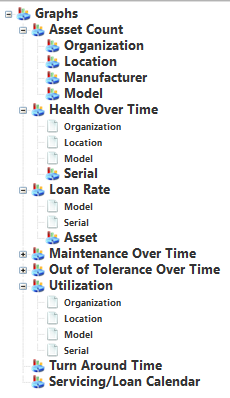

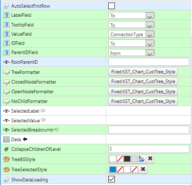

I am trying to implement a tree widget that looks like what you see in the image below.  For some reason the text formatting is a mix of different characteristics (bold, large versus small regular) even though the same style definition is being used for everything.  In addition,  an action occurs only when I click on one of the large bold labels (nothing happens when I click on one of the small regular labels).  I have also attached images of what my widget configuration looks like and part of the infotable data used in the tree

    Do you have state formatting setup for the tree widget?  This can produce the result you are seeing (that screen print does not show that field).
    Additionally you can use the Radio Button (which is really a button set) to control this.  Really you can use any widget that allows selection from an data set (infotable) like a grid, drop down or even a map.

    Not using state formatting.  only 2 styles being used (which has been attached)
