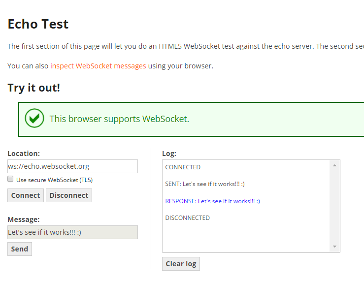

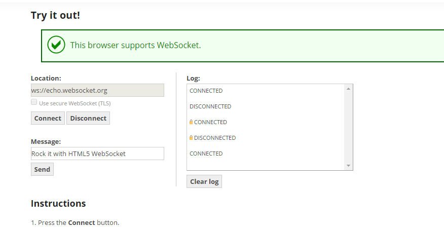

Have you tried to successfully connect to ThingWorx until now using ThingWorx Java Edge SDK ? The problem seems to be caused by your network not accepting websocket connections. Please run the echo websocket test without TLS in your browser to make sure websocket connections are indeed allowed on your network. Simply press connect in the url I linked to above. If you see Connected as in the picture below then websocket connections are allowed on your network.
On the other hand if your network fails the echo websocket test, please contact your network administrator to have them enabled or try using a different network. We are currently working on updating all academic hosted instances to https ThingWorx 6.6 instances, this will solve the websocket handshake problem in the future. Unfortunately we don't have an estimated time when this process will be completed.

Hi Veronica,
I tried to run the test as you said and this was the result:
What is incredible though is that I run again the application after the test without changing anything and now it works!!! I don't have really know how but it does! The only explanation is that something in my network wasn't working well before!
Thank you for answering in such a short amount of time! The test was useful to understand if it was a problem that I had or not! I really appreciate it!
