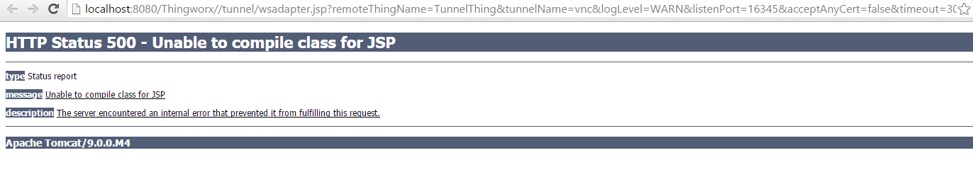

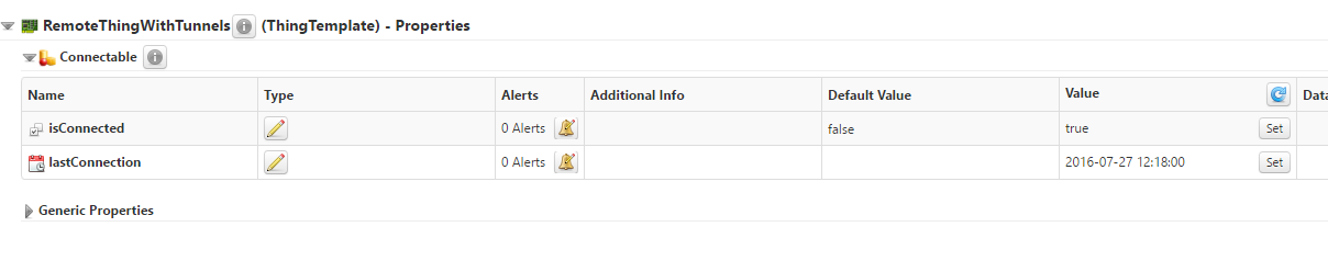

Above code is working and connecting to My Thingworx Below in figure show that connection property is true.

But Facing a problem after click on Remote Device icon Shown Error like first Figure.

Thanks Ravi , I resolved the problem using "ThingWorx Asset Manager" ​Use Asset Remote Transfer things for Remote System from Windows machine to Thingworx Mashup.

Mayank, I see that there's an extra / adding to the end of Thingworx in your URL. In your RemoteThing (with the Tunnel Template), navigate to the Configuration section and clear out the App URI if you have anything in that field.

Can you post the configuration on your RemoteThing?
