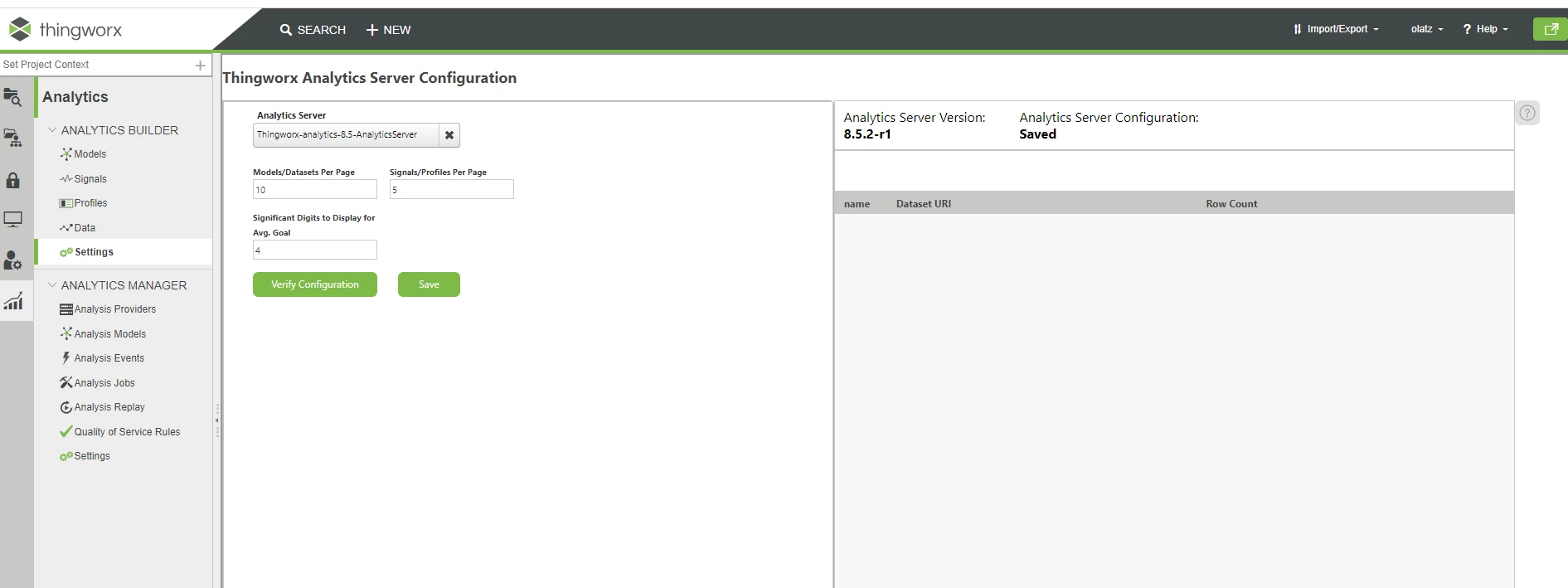

Problems installing Platform-Analytics 8.5.1
After installing Platform-Analytics, Things (PropertyTransformThing, StatisticalMonitoringThing, StatisticalCalculationThing) are not created in the platform.
My environment is:
- Virtual Machine 1
     - THW Platform: 8.5.2
     - SSL:443
     - Autogenerated certificate
- Virtual Machine 2
     - Analytics Server: 8.5.2
          - Connected to the platform and it seems working (see attached: "Analytics-Server.png")
    - Platform-Analytics: 8.5.1
          - RabbitMQ and Apache Flink from the installer
          - Erlang 21.0
          - The installation summary said that everything went OK and Things were created, but I can't find them on the platform. In addition, in the install.log file it seems that connection with the platform went OK:

May 12, 2020
Hi @olatz
Thank you for the TWALogCollector output ... and apologies to make you repeat your setup.
The issue is due to the fact you have several installation of Java on the machine and Analytics Server is using one (in which the certificate appears to have been imported) and Platform Analytics is using a different one without the certificate.
It appears also that Platform Analytics is using a openJDK 11 which is not supported - we support only Java 8.
There is also a misconfiguration between /etc/profile and /etc/environment.
Here are the steps I would advise:
1) Edit /etc/environment and change
export JAVA_HOME=/usr/lib/jvm/jdk1.8.0_241/
to
export JAVA_HOME=/usr/lib/jvm/jdk1.8.0_141/
2) Edit /etc/systemd/system/twpas-descriptive-analytics-service.service and /etc/systemd/system/twpas-property-transform.service
in both file you have a line that starts like
ExecStart=/usr/bin/nohup /usr/bin/java ...
Replace this with
ExecStart=/usr/bin/nohup /usr/lib/jvm/jdk1.8.0_141/bin/java ...
3) Reboot the VM and try again.
This should make Platform Analytics use the same JDK as Analytics Server and so see the certificate.
However I do see that flink failed to start because it is also using the JDK 11, hopefully the steps above will allow to redirect flink.
If it still does not work you may have to uninstall the openJDK 11, Platform Analytics and re-install Platform Analytics.
