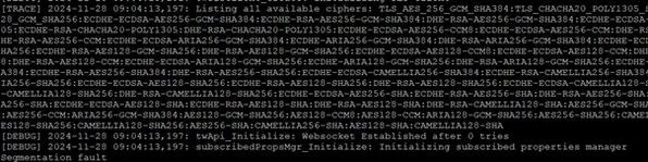

To compare the operation with a different equipment (Linux), we run the example “SteamThing” on a Raspberry pi 4. Everything is OK when using the option:
#define TW_DICTIONARY_MODE TW_DICTIONARY_MAP
In file twDict.c
But when we change TW_DICTIONARY_MODE to TW_DICTIONARY_LIST, We get a “Segmentation fault” error:
Do you have any idea what could be causing this problem?
We wonder if there's a problem somewhere in the list management (list.c file).

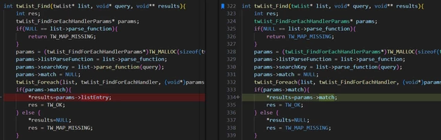

Best answer by amejia1
The problem has been identified and corrected:
My solution (right or wrong?.... but it works)
Before                                                                               Now
consequently the variable "listEntry" in "struct twList_FindForEachHandlerParams"  isn't necessary
amejia112-AmethystAuthorAnswer
November 29, 2024
Before                                                                               Now
