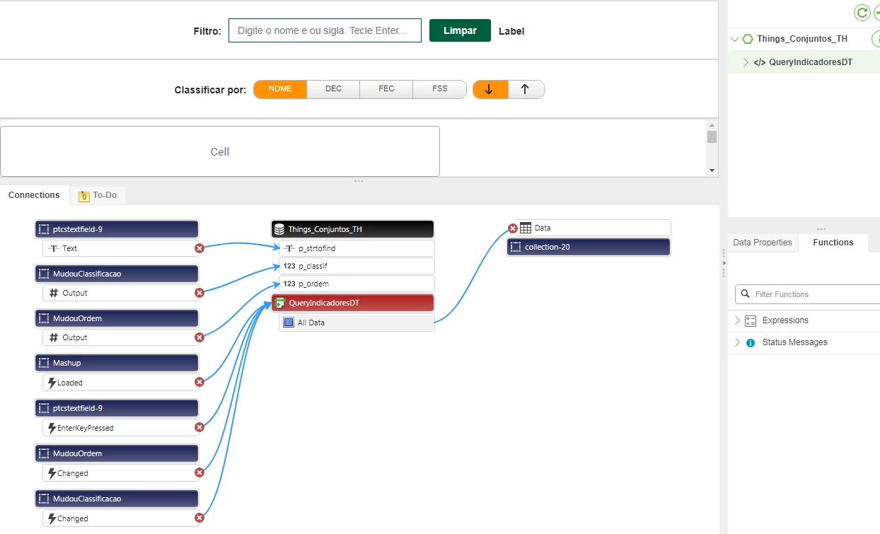

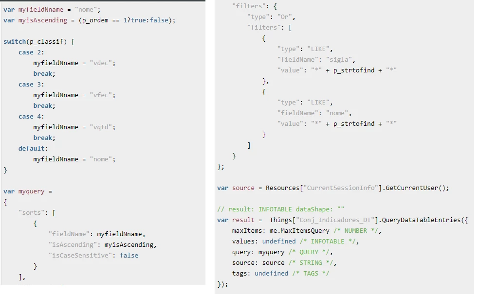

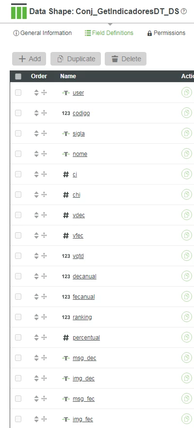

I have a data table with 17 fields and 296 records - figures 1 and 2. To show the records for this data table I have a mashup as shown in figure 3 containing a textbox, two buttonbars and a collection. The service that loads the collection is in figure 4. Basically what this service does is to filter and / or sort my data table.

# 1 - Since the data table has additional indexes in all fields where the collection can be filtered, why does the service take so long to load the collection when I don't use any filters?
# 2 - I can click on only one cell in the collection at a time. If after that I use any filter or change the sort option, how can I make the previously selected cell be selected again, since every time I filter or sort the data table, it redoes the collection?

Thank you for the response, Marcus.  There are three things we can attempt to isolate the issue:
1. In the service code, add debug timing around the data table lookup such as:
var currentTime = new Date();
// Data Table Query code
var endTime = new Date();
var diff = (currentTime.getTime() - endTime.getTime()) / 1000 / 60;
logger.error("+++ delay: " + diff + " seconds ");
2. In the Mashup, load developer tools, go to the network tab, and capture a .har file per https://www.ptc.com/en/support/article/CS224691
3. In the Mashup, repeat the test above, but record the performance in the performance tab
This will help us determine if the delay is in fetching the data, processing the service, or rendering.
