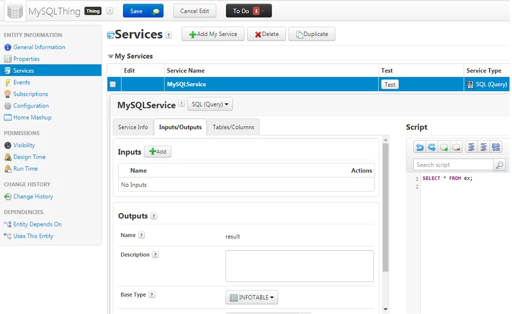

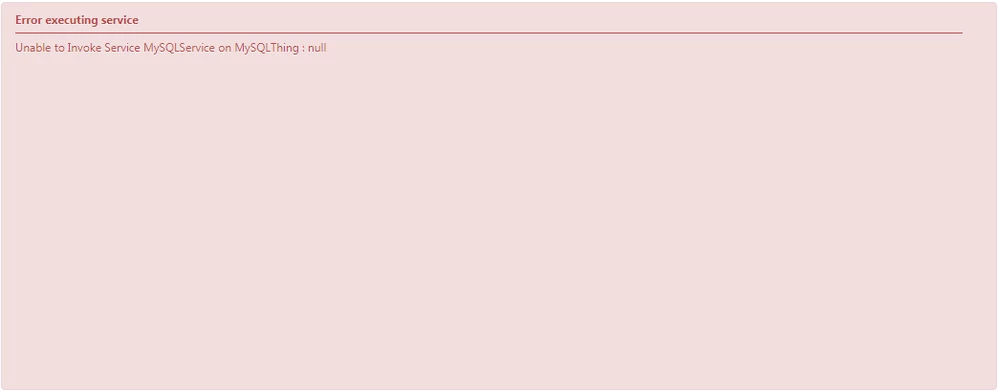

Hello! Perhaps there was already such a question, but still. A service of SQL-query type produces the following error when I try to test it:
There is a connection to the database itself, there is a data in it too. As I understand, the problem is that my service is perceived as empty. But I don't understand what could be wrong.

The problem with this extension is that it's pretty old and contains very old drivers (as noted in the marketplace, it's no longer supported).: https://marketplace.ptc.com/apps/195356/jdbc-connector-extension#!overview
What I suggest trying is what I described in my response in this thread https://community.ptc.com/t5/ThingWorx-Developers/Using-a-third-party-Jar-file-for-Database-connection/m-p/514861?collapse_discussion=true&page=2&q=jdbc%20extension&search_type=thread

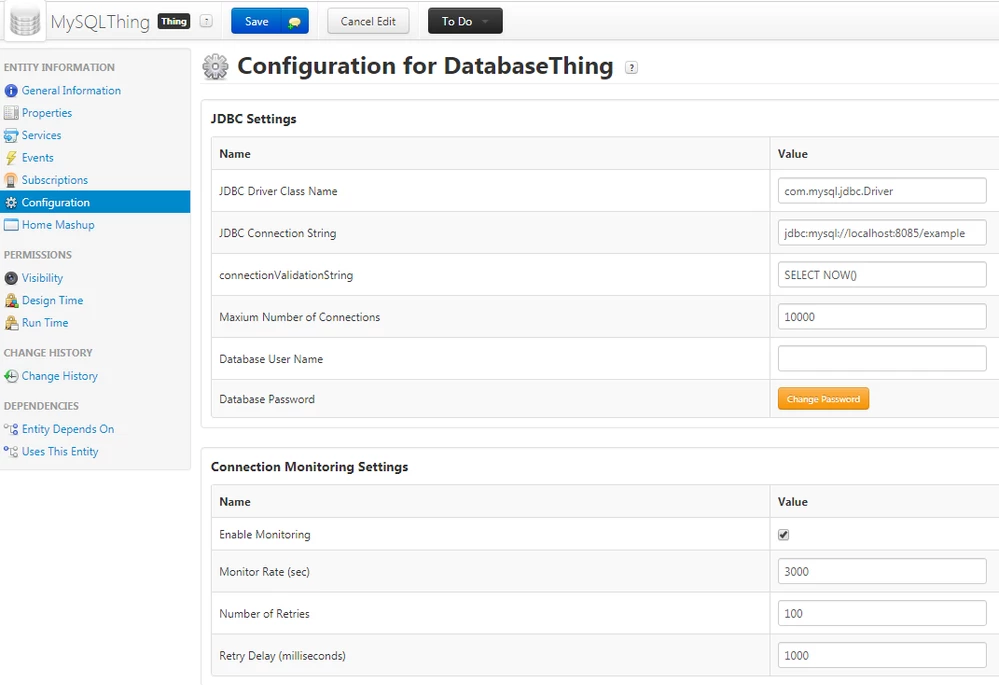

How did you check your database connection? What is your configuration on the jdbc thing?
May 22, 2019
I took the configuration from MySQL Extension and changed the name of the database and address:

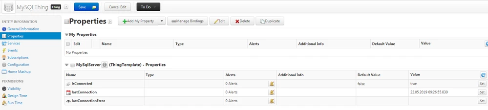

In properties I set the isConnected property to true:
The service itself looks like this:
"ex" is the name of the table in the database "example"

Please refer to this page to change the connection string and the validation string accordingly:
http://support.ptc.com/help/thingworx_hc/thingworx_8_hc/en/#page/ThingWorx%2FHelp%2FExtensibility%2FJDBCExtension%2FJDBCConfigurationExamples.html%23
When you database is properly connected -- you should not be changing isConnected to true, it will set automatically -- in your service, click on tables/columns and you should be able to see your data. If it's not properly connected you won't see anything.
