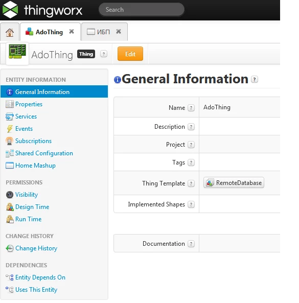

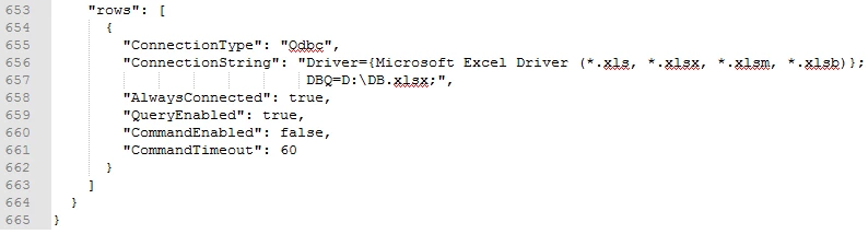

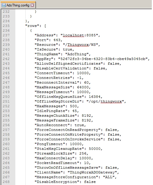

I'm trying to deal with the ThingWorx Edge ADO Service. I performed the configuration for the AdoThing.config file, specifying the address, port and Appkey - as well as the type of my database driver (Excel) and the ConnectionString. I also created an AdoThing Thing like a remote database. But there is no connection at the moment. I'm sure that I made some mistake and didn't take into account something, but I don't know what and where. Please, help.

In addition to this I discovered the following in the Application Log:
2019-07-16 15: 32: 14.092 + 0400 [L: ERROR] [O: ctcpmDispatchingServerCommunicationModule] [I:] [U:] [S:] [T: http-nio-8085-exec-4] Application key 'ADO' expired!
2019-07-16 15: 32: 14.108 + 0400 [L: ERROR] [O: ctcscjJsr356ServerConnection] [I:] [U:] [S:] [T: http-nio-8085-exec-4] Unable to send error ResponseMessage [details: Error [context: authenticating connection] [cause: Application key 'ADO' expired!], cause: WebSocket session is not open, cannot get Basic RemoteEndpoint]
2019-07-16 15: 32: 14.108 + 0400 [L: ERROR] [O: ctcscjJsr356ServerConnection] [I:] [U:] [S:] [T: http-nio-8085-exec-4] Error [ authenticating connection], Server websocket will be closed. cause: Application key 'ADO' expired!
After creating a new key and editing AdoThing.config it all worked.

Hello. Thank you for your answer. I installed ADO Service using a different instruction, and step 4, which you mention, goes there at the very beginning. Only after its successful execution AdoThing.config file is created. And here is the opposite. Anyway, I don't see any records in the logs associated with this connection. Most likely, there are no errors, because there was not even an attempt to establish a connection.

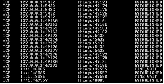

As it seems to me, this is due to the incorrect filling of the AdoThing.config file. For example, I don't quite understand what needs to be specified for the "port" in the screenshot above. Making a request for ports, I saw the following:
And it's not clear which port is the port of the ThingWorx Server. If we are simply talking about TCP, then it should be "443", as I understand it, that is, the default value
