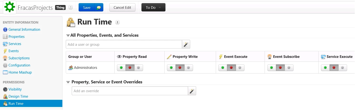

Hello everyone! I have two problems with users.
First. I'm creating a new user (on behalf of the member of the Administrator user group), but when I'm trying to login, these password and login are perceived as unacceptable.
Second. After setting the permissions (also on behalf of the member of the Administrator user group), that deny to execute services of particular Thing, I don't see any difference in my mashup (the Grid widget, binding to one of the forbidden services, is continuing to display the data).
What could be the problem in each case?
Jun 16, 2018 2:51 PM UTC
You are denying Administrator Runtime all permissions with the given screenshot.
Jun 16, 2018 4:06 PM UTC
Yes, but in this case it doesn't matter. The most important is that I denied service executing, but the widget in my mashup still displays the data for this user group.
Jun 17, 2018 8:39 AM UTC
Administrator is the in built user group which by default has access to everything in the composer .Be it any service execute or any design time .What is the use case here you want the admin group to not have access to a particular thing ? What is the purpose of doing this kind of setup ?
