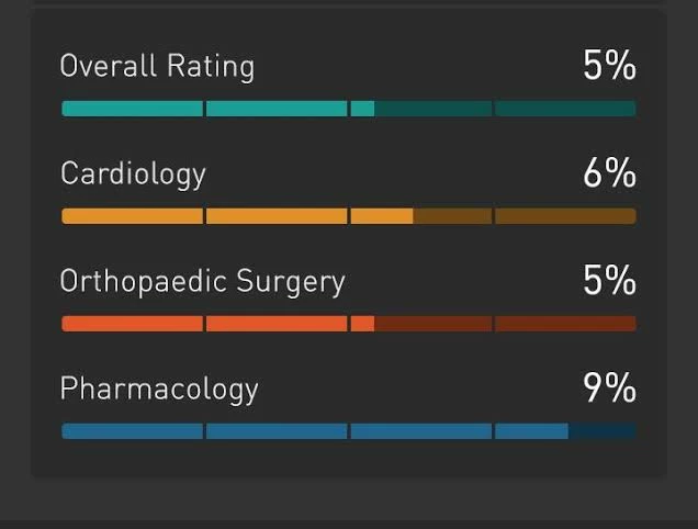

Hi community,  i want to create a progress bar with multiple breaks in it and need to show that break in different colour in the progress bar in thingworx.

Yes i have a progress created as mentioned in the document. In my case need to have separator inbetween the progress bar. The separator can be in any point and the progress bar can also have multiple seperator. Is there any widget go show this based on any state definition or any custom css can be used.i have attached a file . Any help is appreciated .

What I used to do in the past is overlay widgets over each other. Like have a progress bar and over it have a .png with the transparent part to show the progress bar beneath it.
Example:
This is from the Brewery demo.
