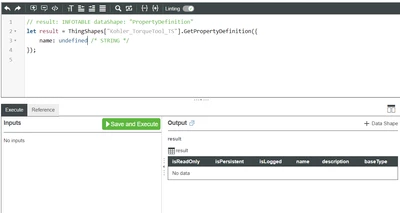

Is there a snippet or service to fetch the list of properties in a thing shape to display as infotable? I tried the GetPropertyDefinition from the ThingShape but it returns empty infotable. I wanted to fetch all the properties defined in the thing shape. How can we achieve this use case?

There isn't an easy way to do what you want.
I think it will have to be something like a GetPropertyValues on the Thing and then some filtering or looping through to build your final infotable.
You can look into using Categories potentially.
