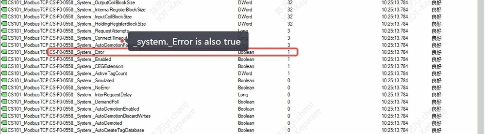

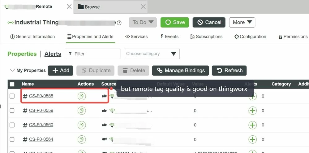

    I set up remote property on thingworx, but quality of tag is inconsistent on thingworx and kepware.
  •  quality of the remote property on thingworx is GOOD as the the screenshoot
  • but I checeked this tag on QC which is provided by kepware. The tag quality is UNKONWN, and _system._Error of this tag is also true.
    I am so confused with this inconsistancy, could anyone tell me which quality is correct?

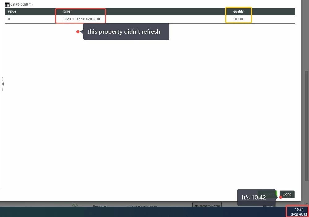

Hi @LeoChen ,
How certain are you that the property value in Composer is the same as the one in the OPC Client?
I am asking this because Composer only gets the VTQ (which includes the Quality that derives the thumbs up/down) when you click the the Properties tab or when you click the Refresh button.
There's a service called GetPropertyValuesVTQ (or GetPropertyTime if you want to be specific) - execute that and compare the property timestamp with the one from the OPC Client. If indeed the timestamps are the same, the question is valid (not that I can answer why).
But still, we would need to know this first.

they are sure the same one on thingworx and modbus server of kepware, because this tag is setted up by myself.
the result of excuting GetPropertyValuesVTQ is as fellows:
  • property did't change as time goes by
  • checking value on qc provided by kepware, quality was bad at 10:42

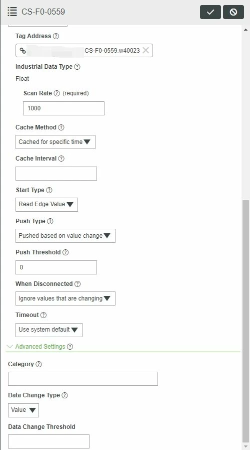

Is there any misconfiguration on thingworx? Configurations on thingworx are as fellows:
Thank you very much.
