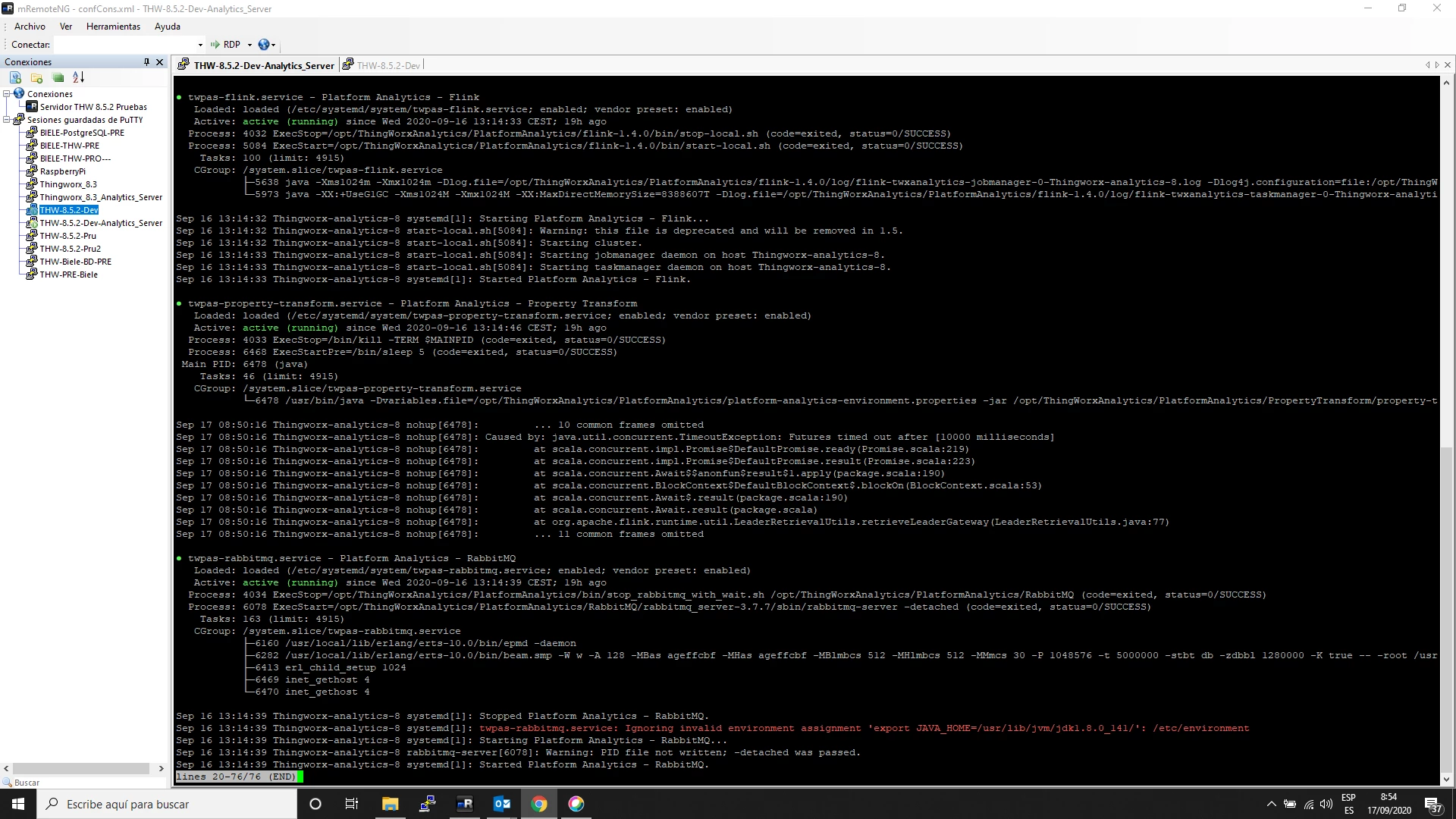

After installing Platform-Analytics, Property Transform is not working.
My environment is:
- Virtual Machine 1
- THW Platform: 8.5.2
- SSL:443
- Autogenerated certificate
- Virtual Machine 2
- Analytics Server: 8.5.2
- Connected to the platform and working
- Platform-Analytics: 8.5.1
- RabbitMQ and Apache Flink from the installer
- Erlang 21.0
- The installation summary said that everything went OK and Things were created
I have the following error in configuration.log: (attached)
2020-09-17 08:59:41 [pool-1-thread-1] ERROR c.t.a.d.c.FlinkStatusCheck - Error while checking status of Flink cluster
org.apache.flink.util.FlinkException: Could not connect to the leading JobManager. Please check that the JobManager is running.
at org.apache.flink.client.program.ClusterClient.getJobManagerGateway(ClusterClient.java:862)
at org.apache.flink.client.program.ClusterClient.listJobs(ClusterClient.java:700)
at com.thingworx.analytics.derived.configuration.FlinkStatusCheck.check(FlinkStatusCheck.java:45)
at com.thingworx.analytics.derived.configuration.FlinkStatusCheck.lambda$new$0(FlinkStatusCheck.java:33)
at java.util.concurrent.Executors$RunnableAdapter.call(Executors.java:511)
at java.util.concurrent.FutureTask.runAndReset(FutureTask.java:308)
at java.util.concurrent.ScheduledThreadPoolExecutor$ScheduledFutureTask.access$301(ScheduledThreadPoolExecutor.java:180)
at java.util.concurrent.ScheduledThreadPoolExecutor$ScheduledFutureTask.run(ScheduledThreadPoolExecutor.java:294)
at java.util.concurrent.ThreadPoolExecutor.runWorker(ThreadPoolExecutor.java:1149)
at java.util.concurrent.ThreadPoolExecutor$Worker.run(ThreadPoolExecutor.java:624)
at java.lang.Thread.run(Thread.java:748)
In the flink1-4 log file, there is no error printed (see attached), the only thing that seems strange is the message "JAVA HOME: (not set)" because in /etc/environments
export JAVA_HOME=/usr/lib/jvm/jdk1.8.0_141/
is set.
I can't find any reference related with the error I am getting with flink in the knowledge database.
Thanks in advance for your help.
