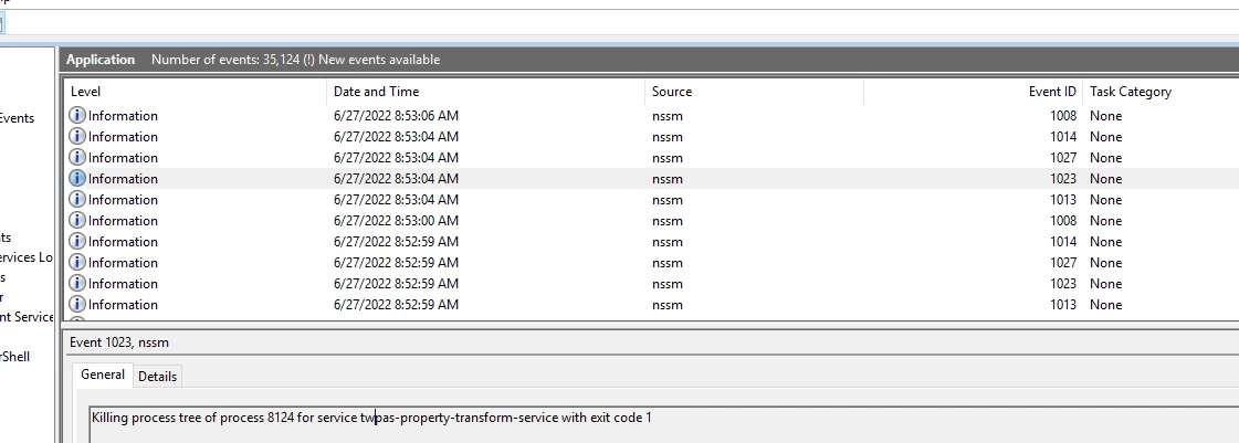

Hello, I am having trouble with thingworx analytics where my property transform thing does not connect. All the windows services are running, and I can see analytics builder / manager in the composer along with creating models/ etc.

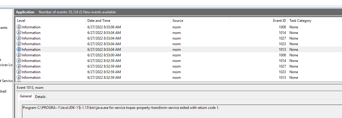

I keep seeing the attached windows events occurring, which are filling up my temp folder when the twpas-property-transform-service is enabled.  When I disable the above service, the events stop.
Following the procedure below, I updated the owner with admin rights for both analytic server / platform analytics with no effect.
https://support.ptc.com/help/thingworx_hc/thingworx_analytics_8/#page/analytics/change_user_windows.html
Running on Thingworx V9.3 and analytics V9.3.

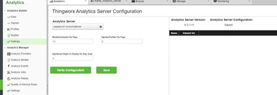

Hello, I verified we are running Thingworx analytics V9.3 as shown below.
Can you confirm your Platform Analytics version? Also please provide the Windows Host Operating System in use. also please verify that JAVA_HOME and ERLANG_HOME has been set as per the documentation.
