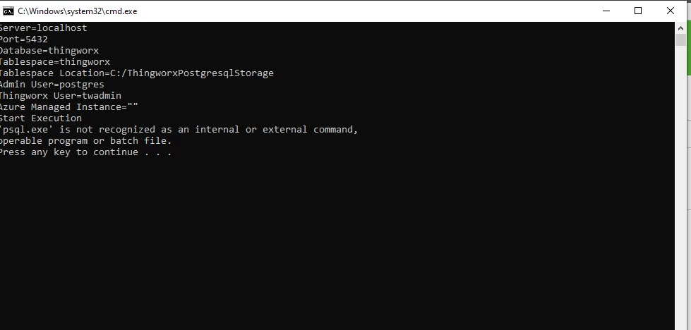

psql.exe' is not recognized as an internal or external command, operable program or batch file.
I have thingworxPostgresDBSetup.bat file run time
Error came..what can i do?
so pls consider me..after reply me
Jun 23, 2020 11:31 AM UTC
Please try adding path (bin directory of postgres installation) in the path variable of your system environment variables.
