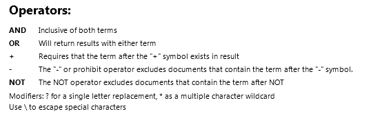

PFA the PNG for operators used in SearchExpression
