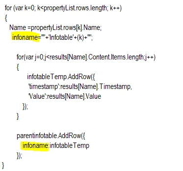

pushing values to child infotable using for loop dynamically
I want to push values to child infotables dynamically using nested for loop, in the above code the "infoname" parameter is the child infotable names which are dynamic.
While executing the code i am not getting any issue, but the infotables are showing blank.
if i am passing the actual name instead of "infoname parameter" the values are showing in that particular infotable.
Is there any way to pass values to child infotables dynamically?

What @Sathishkumar_C  meant was:
for...{
   infoname = "Infotable"+k;
   for..
   let newRow = {};
   newRow[infoname] = infotableTemp;
   parentinfotable.AddRow(newRow);
This may work but some points on this:
- dont forget to recreate the "infotableTemp" on each run (or it will just keep adding rows and rows)
- having a different name for each nested infotable does not make much sense

Try to add blank row first... than you can update dynamically..
parentinfotable.AddRow({});
parentinfotable.rows[parentinfotable.length - 1][infoname] = infotableTemp;

Hi Sathish,
Have added blank first row as mentioned, but still the child infotables as coming null.
Thanks.
August 26, 2022
try to share the code and sample data here..
