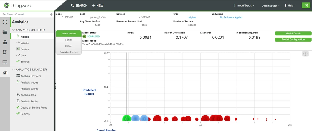

There is no out of the box way to list models, profiles, and signals at one time in Analytics server but they can be done individually in Analytics Builder by selecting the desired job type (ex. models) from the Analytics tab in ThingWorx Composer.  The Screenshot below shows the details of an analytics model.Models.PNG
Let me know if this answers your question.
