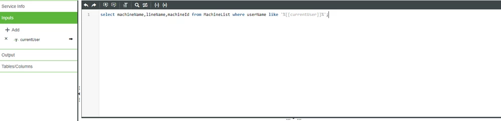

Hi ,
you should prepare  your query like below if you are using two wild cards together.
select * from user_model where name like '%' || [[UserName]] || '%'
