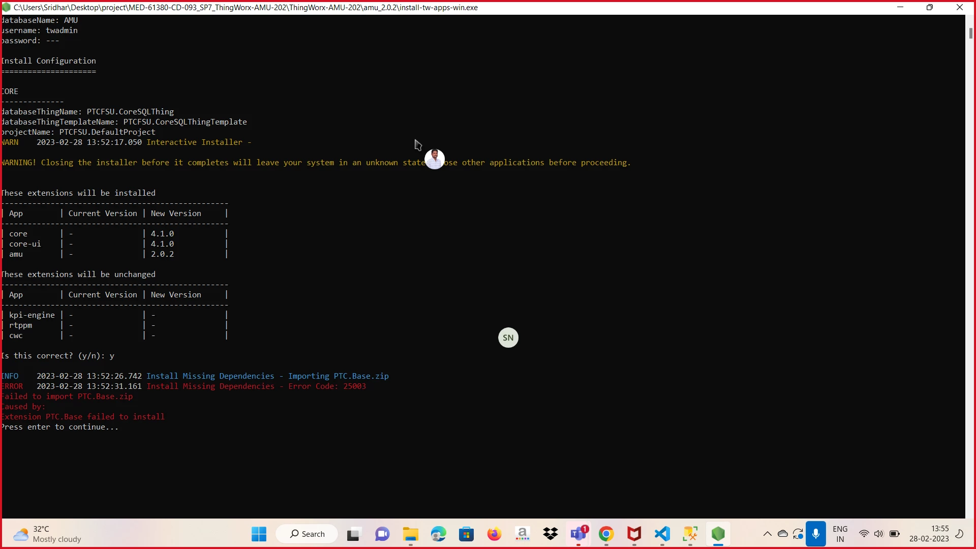

I'm using Thingworx MSSQL  9.3.7 in my local system. In that I'm trying to install the Thingworx AMU Application - V2.0.2  for my project exploration purpose. Also following the steps which are provided in the Installation support AMU Installation Link.
But when I'm executing the installer with the respective values I'm getting some error message of
Install Missing Dependencies - Error Code: 25003
Failed to import PTC.Base.zip
Caused by:
Extension PTC.Base failed to install
Please find the attached image for reference.
Note : Extension Import Policies are also updated in the Platform-Settings-JSON file.
Kindly help me to fix this.
Thanks in Advance.

Article - "How to fix installation errors on Thingworx Apps - PTC.Base is licensed but cannot find feature in license_capability_response.bin file": https://www.ptc.com/en/support/article/CS381730
VladimirN24-Ruby IVAnswer
Arun_C16-PearlAuthor
Thank You @VladimirN . Its working now after licensing the Thingworx Platform.
