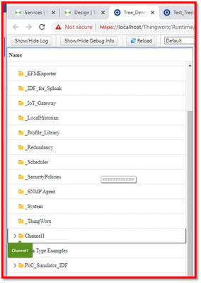

I need to retrieve Kepware channel &  devices with below in the sub group's in Tree Grid Widget. I have tried to use the existing service of "BrowseGroups" for parent & child data based on the selected "FullPath".
But In runtime when I expand the Parent, it's not working properly.
Kindly find the attached snapshot FYR, it will show the service bindings & widget main field configuration.
Please help me with any other additional steps need to be taken care.
Thanks in Advance,
Arun C

 By doing given workaround for the time being I have fixed query.
Step 1: Created a service to load the complete of Parent & Child Data in 1 shot as like complete hierarchy structure by looping connectivity thing service of "BrowseGroups"
Step 2: Service output is connected with Data Property of Tree Grid Advanced and ID Fields values are configured with respective column name.
Thank you.
