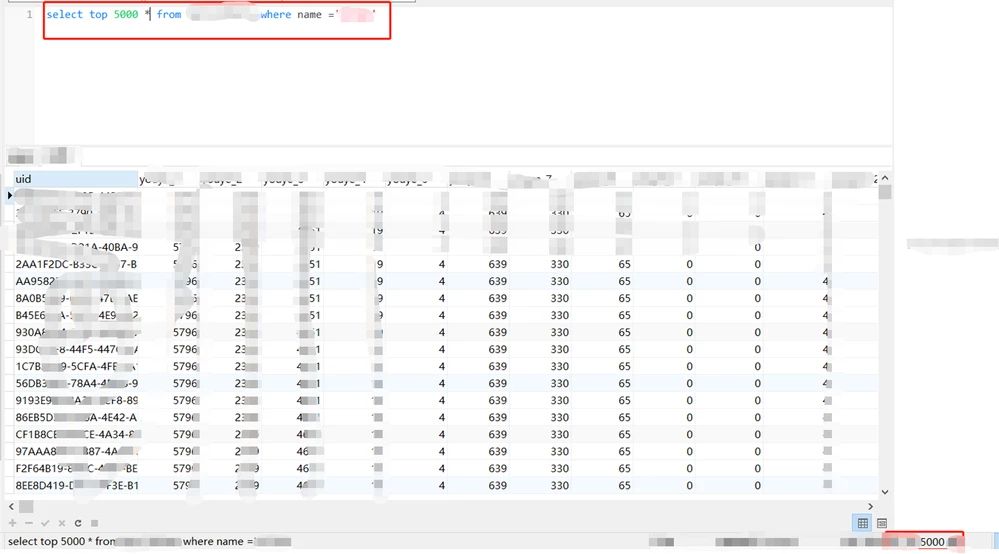

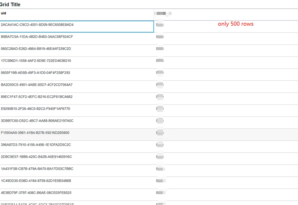

Hi, everybody.
Why is it that a database query has 5000 pieces of data, but a query in thingworx only has 500 pieces of data?

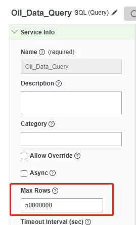

This is here of solution,only Modified here to 500+.

Apr 29, 2024 6:38 AM UTC
