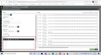

query to filter in thingtemplate services
Please tell me the query format to write in this tab to filter rows.

Jan 4, 2022 11:55 AM UTC
Iam getting error when i given this query. What is the mistake here. @M4RC
"filters":
"type": "AND",
"filters": [{
"type": "EQ",
"fieldName": "MachineName",
"value": MachineName
"type": "EQ",
"fieldName": "TaskName",
"value":oldTaskName
Jan 4, 2022 12:18 PM UTC
You can try this:
{"filters":
  "type": "And",
  "filters": [
     "type": "EQ",
     "value": "MachineName"
     "type": "EQ",
     "value": "TaskName"
Example for Values:
"value": "string"
"value": 10
"value": 1.2
You need to remove the last ;
