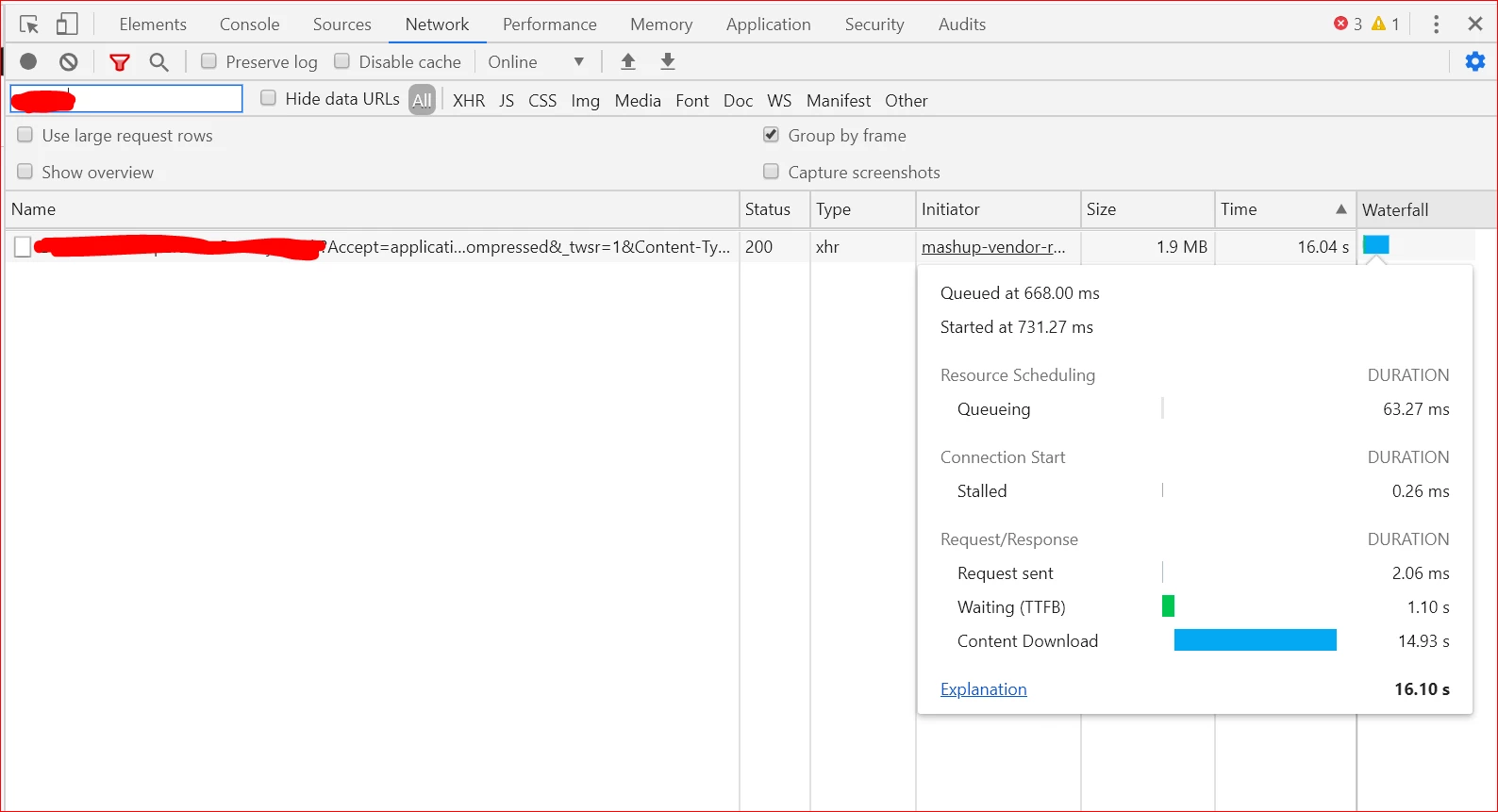

I am rendering data as: 1 Thing * 20 properties*updates every 10 minutes on a Label chart. And want to display for different date range like last 7 days,30 days,45 days,etc.
1. Mashup Structure- Its pretty simple bind of QueryNamedProperties service to "All Data" with required start/end date.
2.Properties logged-Yes, required properties are logged to "ALWAYS".
3. Slowness is being shown-It is being tested by 2-3 folks for now. But going to be used by more than that.
4. Its a Postgres instance and hosted in a Cloud VM.
5. Please find the attached snapshot for request-response time details. This request is for last 8 days only.
Vlad's comment: that's the main clue. The content-download time is extremely high for just 1.9MB
In light of these findings I suggest the following:
-use your favorite REST client (Postman, Soap UI etc) and replicate the REST call you showed us in the Developer Tools. Execute this call from the same computer as the one you experience the slowness.
I believe (but I'm not 100% sure) that you should see the same response time as the one from the browser, which would lead me to the conclusion that there's something (proxy, firewall, ISP internet speed) that slows down the download of that HTTP response. Obviously, in such cases if your policies allow it, you can test this behavior from another computer and network (by using the REST call you created above or accessing the mashup) and see if the content download time is the same.
