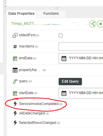

I have a Thing with a ValueStream that shows perfectly into a mashup with QueryPropertyHistory.
I'm trying to do the same with QueryNamedPropertyHistory. I have defined a new property in the thing called "Output" (name, description) that I have correctly filled (it is shown in the center grid of mashup).
I bind this Infotable "Output" into "propertyNames" and I expert that services returns and show the data in the top grid, but nothing is shown.
What's wrong?
The top grid is the QueryNamedPropertyHistory (KO)
The middle grid is "Output" infotable (OK)
The bottom grid is QueryPropertyHistory (OK)
M4RCAnswer
Jan 31, 2023 3:00 PM UTC
in your picture with the mashup overview it looks like "QueryNamedPropertyHistory" would be executed before the service "GetProperties" has submitted the output.
Thus, the "QueryNamedPropertyHistory" service is executed without the PropertyNames input and, as you would expect, returns "No Data".
I recommend to bind the event "ServiceInvokeCompleted" from the "GetProperties" service to the "QueryNamendPropertyHistory".

Jan 31, 2023 3:36 PM UTC
It works!!!
Thanks.... I have learned a new feature from your reply.
