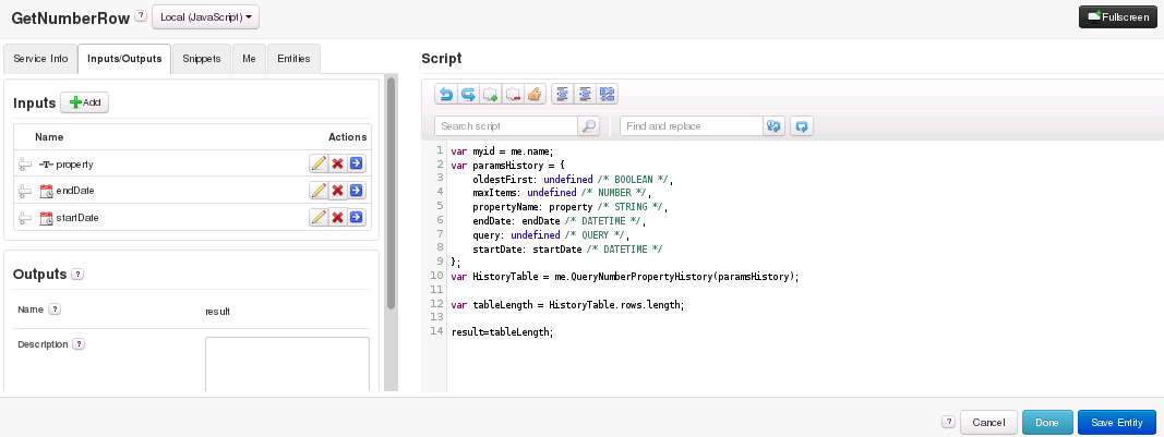

I use QueryNumberPropertyHistory service for DAD and DataConnect transformation as suggested:  link.
The problem is that this service returns "only" 500 rows at maximum.
How could I avoid this limit in order to obtain all rows from startDate to endDate?
I have found also this service: QueryPropertyHistory . but it doesn't work properly because it returns all columns instead of one.
Thank's a lot
Luigi

All querying services on ThingWorks has a default maxItems set to 500. If you want more rows you must specify maxItems value, and no there is no maxItems=Infinite option.

May 30, 2017 7:15 AM UTC
Ok Carles,
now, setting as default a number greater then 500 into a myself service it works.
I don't understood why maxItems input text doesn't works.
If I set 600 into maxItems input text, DAD returns 500 rows, always.
Thank's for the support.
