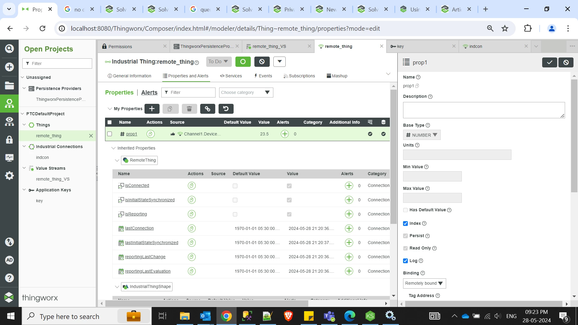

I have a simple remote thing and 1 property which is logged and persist the data change is also set to value.

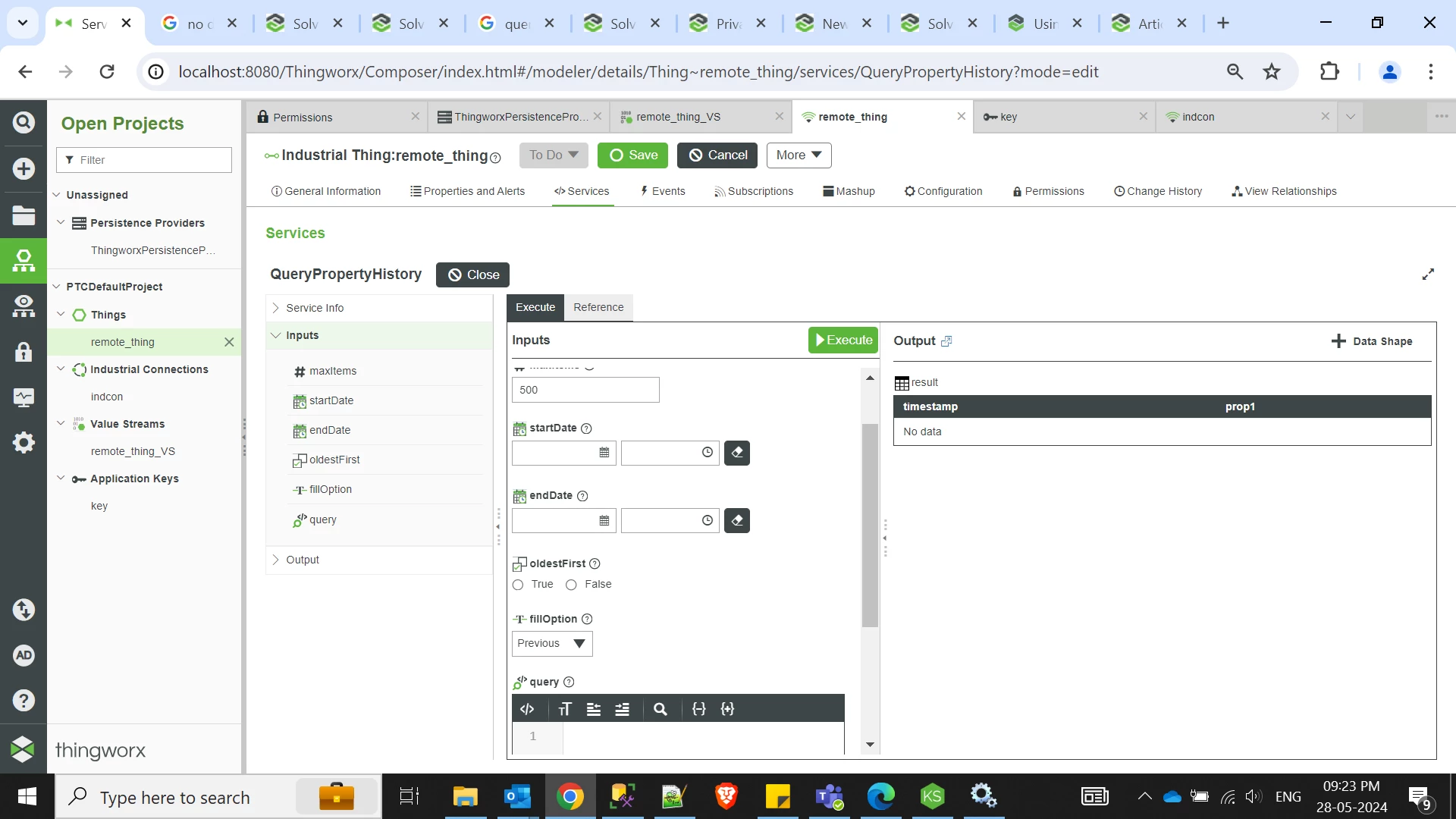

It is getting data from Kepware using industrial connection, on composer it is changing data but on QuryPropertyHistory no data is reflecting please check screenshot.
May 30, 2024 9:38 AM UTC
Installed a fresh new DB and it working fine now, I guess there was some issue in backed corruption of data.
Thanks.

Hi @Pratik_Aswale
Do you see any error message related to remote thing in Application log?
Also check whether you have assigned ValueStream to remote thing
/VR
May 29, 2024 5:18 AM UTC
There are no errors in application logs and I have also attached VS to remote thing
Rocko
May 29, 2024 6:49 AM UTC
Did you assign a value stream to the thing?
May 29, 2024 7:04 AM UTC
Yes I have assigned a value stream
Rocko
May 29, 2024 7:09 AM UTC
Sorry, missed that in your other reply. To isolate the problem: When you remove the binding and update the value manually, does it work then?
