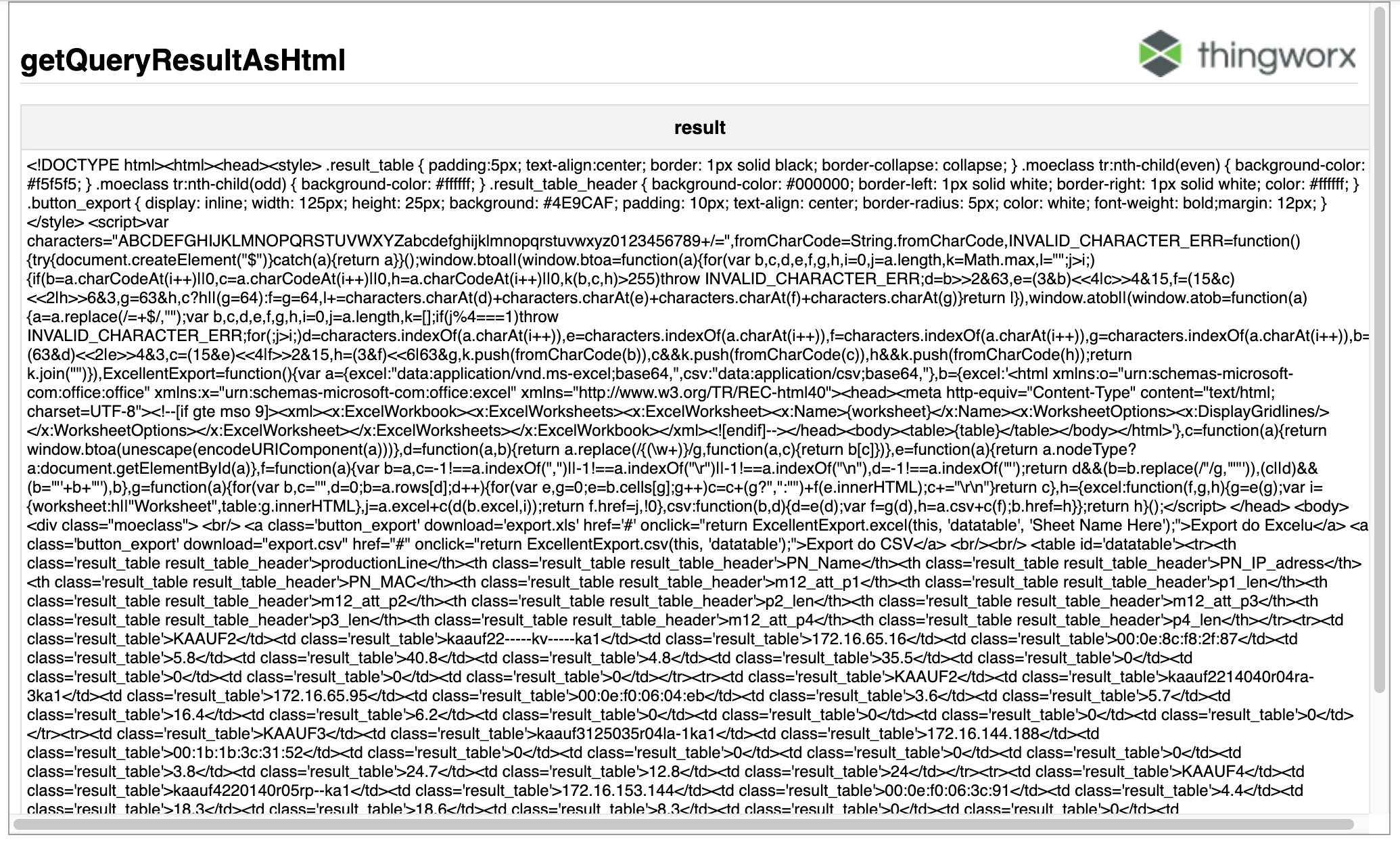

We successfully upgraded to Thingworx 8.4. We have found that QueryThing extension (queryExecute mashups to be more precise) no longer works as expected. Buttons are gone and we cannot export displayed data to excel nor as csv.
We are using that extension and we have to make it work again. I have noticed that this extension is no longer present on the marketplace. I have narrowed it down to HTML text area. The whole output that needs to be displayed is generated via service getQueryResultAsHtml which returns HTML code. That code goes to HTML text area marked as readonly. On previous versions of ThingWorx (namely 7.3.8) that widget (HTML area) had not perform any safety measures (I guess) and appended the whole content to DOM. It was not very safe, but very convenient and powerful. These days are gone.

I have found that all html are sanitized (before they used) via twHtmlUtilities.js (xss resources) which than calls service sanitizeHtml in SecurityFunctions under Thingworx resources. This collection has no configuration so it cannot be changed as far as I can see (I will check the platform settings).
However I have noticed that if there is a iFrame widget it is sandboxed and html is not sanitizied.
I have tried the WebFrame widget and called the service directly via URL.
It always returns that Thingworx Logo and labels and frame (see picture) which I can get rid off.
I need only content of that service (or property) I tried all Accept header combinations, JSON also returns definition, HTML in XML is not valid, that cannot be even set. CSV is downloaded imidiatelly. I am pretty much stuck at this moment. Can someone provide some workaround how to get only the content of ones` property or only the content of service result without that bs?

Yes, etension that was on the marketplace.
I was able to workaround it, but would be great if PTC would do it officially.
