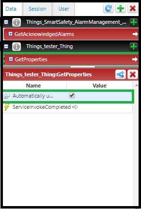

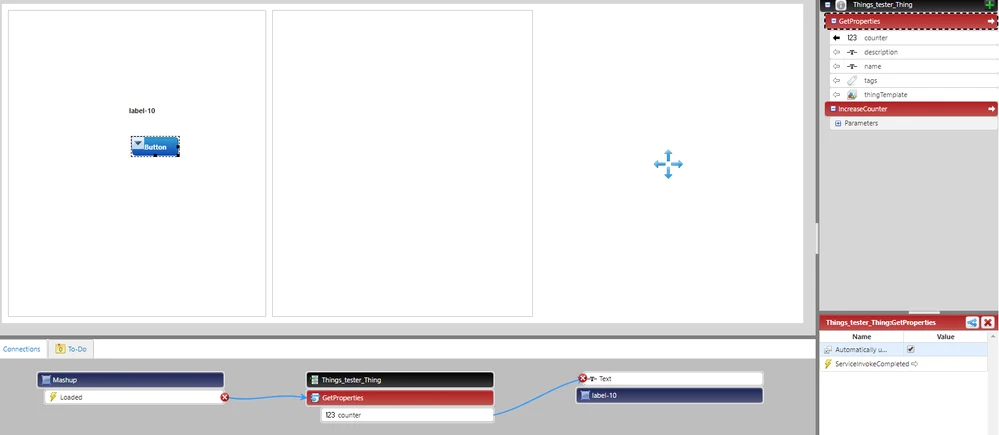

I'm using the web socket feature in TW 7.3 (from Automatically update values when able checkbox), the feature worked only for one time and it didn't work after that at all,
I have the three error messages in the application  log as the following:
Message1:[context: com.thingworx.webservices.context.HttpExecutionContext@24f88415][message: Unable to Invoke Service GetClientApplicationKey on EntityServices : Import Failed: Unable to create applicationKey: [1,018] Data store unknown error: [Error occurred while accessing the model provider.]]
Message2:Unable to process import: Unable to create applicationKey: [1,018] Data store unknown error: [Error occurred while accessing the model provider.]
Message3:
[message: [1,018] Data store unknown error: [Error occurred while accessing the model provider.]]
Could you help me please identify the problem I'm facing.

     You did binded any property of GetProperties result to a visual widget?
    tarik1-VisitorAuthor
    April 11, 2019
    yes, I did Carles, the button increase the counter and the getProperties is bounded to the label, after I click the button the label doesn't get updated
    April 11, 2019
    I noticed that I have 3 error message, I'll update the question
