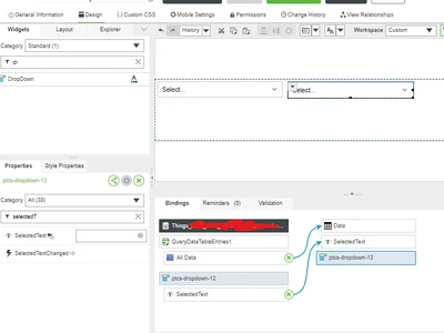

Hello everyone! I've already selected the first box, so how do I get the second box to auto-match based on the things I've selected in the first box?
Rocko
RockoAnswer
Apr 3, 2024 6:23 AM UTC
In that case the selectedItemsChanged event and the Selected Text would be bound to a service called e.g. "GetSubcategories". That service would deliver the right set of values for the second dropbox. The result of the service would be bound to the dropbox.

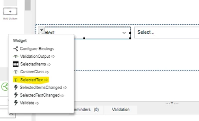

HI @Snoopy_hu ,
Please try with dropdown property of 'SelectedText'.

Snoopy_hu11-GarnetAuthor
11-Garnet
Apr 3, 2024 2:30 AM UTC
Ok thanks, which property should I bind using the drop down property
Apr 3, 2024 2:49 AM UTC
Binding should be like the below image.
Property - SelectedText from source Dropdown 1 to SelectedText of destination Dropdown  2.
Thanks & Regards,
Arun C
