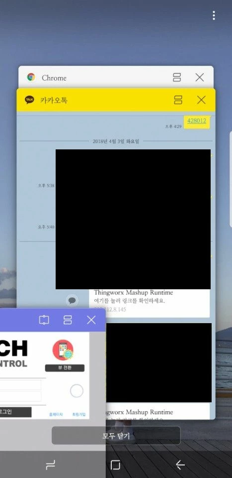

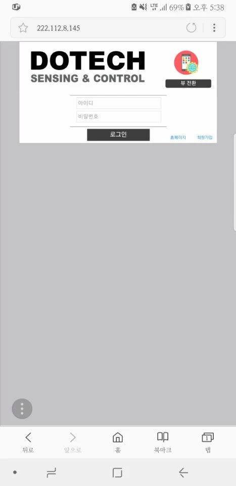

1. Success access mash via appkey
2. force quit browser(or reboot mobile)

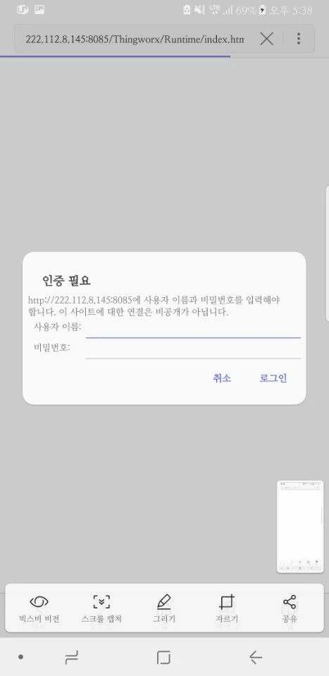

3.If you then run the browser again, it will automatically move to the previous url.
Where url is the first url used with the appkey.
However, the login window is displayed as shown in the picture.
