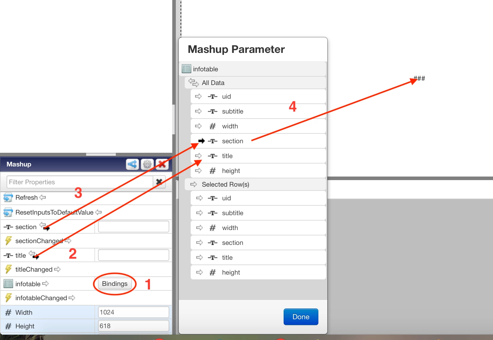

2. One of the features of the Repeater widget I liked and constantly used was the ability to pass "All fields" from the repeater widget to an infotable mashup parameter on the repeated mashup. This basically sent the row's data down into the repeated mashup. In turn, I could hook the infotable's value field to a value display widget, but get to use the other fields in the infotable as a dependent field for state formatting. Is there a keyword, i.e. All Fields to use with the MashupPropertyBinding property so I can map all the current row's data down? Or do I have to build a layered JSON string to map the infotable?

For #2, collection doesn't have any similar functionality. Instead, you can define an infotable parameter on your mashup in addition to the regular parameter themselves and bind from the other mashup parameters to the All Data section of the infotable parameter. Then you can bind from that infotable to the value display to gain access to the other fields. This solution works in all cases where you might want to use multiple separate fields for state formatting. See the attached screenshot for more details.
For #3, collection updates the Data property when in your cell mashups you have something bound back to a mashup parameter that's a collection field. In that case, collection will update the Data property with the new values.
