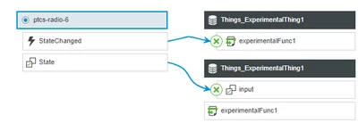

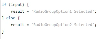

Mar 29, 2023 1:30 PM UTC
In case you are trying to achieve something like below:
red marked is radio group, while the blue one is generic radio button.
Then I have a binding to trigger service which just displays option selected as a basic example.
But hopefully this can be extended to fit your needs with some tweaking.

Mar 29, 2023 1:42 PM UTC
I think I see what you have done.
Basically if the first radio button is not "true" then the second radio button would be (if you have set one of the buttons to true by default).
This approach does work, I was even thinking of having both radio buttons states passed into an expression and do a check like:
if (button1 && !button2) {
 output = 'button1 selected';
else if (!button1 && button2) {
 output = 'button2 selected';
But this would get really annoying if I need to add more buttons in the future.
I suppose if I don't want to use the Generic Radio Button widget I'd have to build my own widget or wait for an update of the regular "Radio button" widget.
Jens
