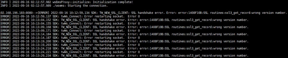

when i study the example Connect Raspberry Pi to ThingWorx, i encounter this problem: 111.png by the way, my thingworx version is 9.1.12-b1048, is this the reason?

September 16, 2022
Thank you! i have solved the problem with the configuration:
"ws_connection": {
"encryption": "none"
