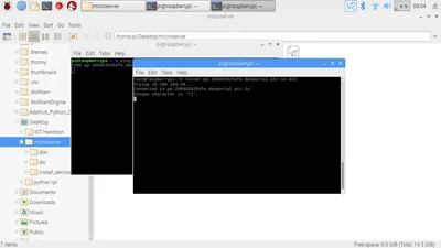

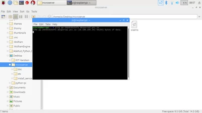

Hello harikj,
I apologize if you have tried this already, but can you ping the Thingworx server from your device? I imagine your EMS is hosted on your Pi OS, so if you could try hitting the server from a terminal session with something like:
telnet pp-2004030254fe.devportal.ptc.io 443
If this results in a blank screen where you can type other commands, that means we are connected fine. Otherwise, an error will appear if the connection on the socket was unsuccessful.
I imagine it will be successful if you are able to log into the platform from a browser on your device (where EMS is installed), so the next thing to check would be the other socket you're trying to use.

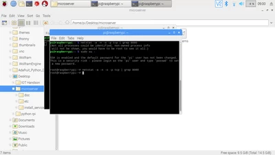

In a terminal again:
netstat -a -n -o -p tcp | grep 8080
If something is listed, something else is already using that port.

I tried everything you suggested.
The EMS is hosted on the Pi.
Here are the logs with Logger  set to DEBUG
