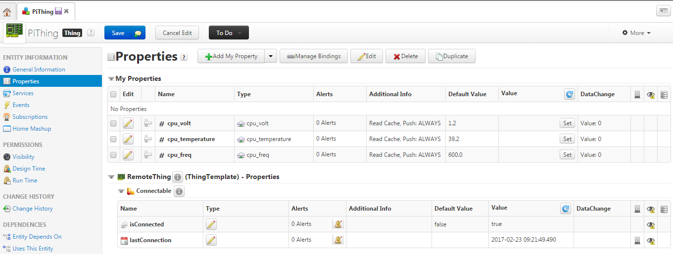

Tori Tielebein: I have followed your instructions, but without success. I have created a new thing based on the RemoteThing template. Under Properties when I click Manage Bindings and select Remote it gives me the message: "Loading... Error browsing properties. Be sure the remote device/server is connected and configured properly". Even though I see the PiThing in my Thingworx Monitor as a Unbound Thing.
Aanjan Ravi​: I have tried your advice which worked partially. My config.lua file looks like the following:
scripts.log_level = "TRACE"
scripts.PiThing = {
    file = "thing.lua",
    template = "PiTemplate",
    identifier = "PiThing",
    scanrate = 1000,
    taskrate = 30000
scripts.rap_host = "localhost"
scripts.rap_port = 8080
Running WSEMS and LRS with this configuration gives me different results. First of all now I see 2 PiThing​s in the Thingworx Monitor. One with the "Is Identifier" checkbox checked and one unchecked. The output of WSEMS and LSR (which i have attached as well) are slightly different, but still show the HTTP 500 error.
With this setup I can actually bind the properties of my PiThing (cpu_temperature, cpu_freq, cpu_volt) to a RemoteThing within Thingworx Composer via the Manage Bindings menu, but the values stay blank.

hello,Aanjan
When running wsems EMS can connect to the platform but appears this problem
[ERROR] 2017-02-22 03:39:20,806 emsRequestHandler: Thing not bound to EMS, or host is not set
why?
Hope you can help me
WangNi, do you have an auto_bind section defined in your config.json? You would get this message if you're connecting the EMS to your platform, but don't have it associated with a Thing yet.
hi Aanjan,
but The platform can read the properties
Can not refresh
