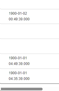

HI All,
I would like to understand.
Why if I have a column of the Time type in the database where I only save the time.
Results from DB looks like that Im using MY SQL SERVER
And I invoke it on the TWX side
Does the time move exactly 50 minutes and 39 seconds forward?
What's going on inside TWX with date data types?
I checked the location of the server and browser - we are in the same time zone.
How can I display exactly the same value like I have on DB?

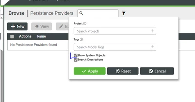

    I can help you without any problem. This is a very right way to change from datatables to SQL database. I have 8 years exp with Thingworx and datatables its not good way to store a large amount of information.

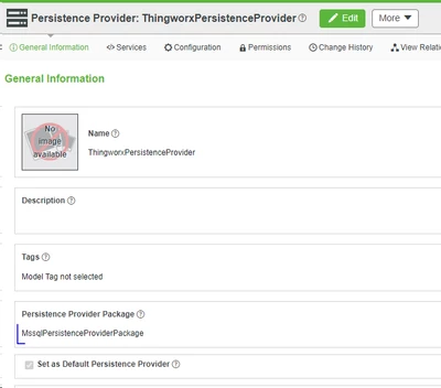

    1. First of all please check what kind of persistence provider you have. Each DB has own TWX version.
    you can find it here:
    You need to select 'show system objects'
    I have MYSSQL persistence provider. You can find postgree persistence provider.
    I mentioned about it because if you have MYSQL persistence provider this kind of DB will be easier to connect with TWX.

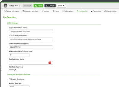

    Next you need to crate thing with DataBase or MYSQL Thing Template and you should choose Configuration Tab.
    You should provide all information about your DB.
    After when you establish connection with your DB you are able to create SQL Query and Commands (Commands are dedicate for Insert, Update,Delete)
    Please don t mix SQL services with JS services inside one DB thing because it will create bottle neck with performance.

    Feb 13, 2024 2:29 PM UTC
    Hi @JK_10565232
    ThingWorx supported UTC zone and you need to change it on your DB side as well, and if required to convert it to your local time zone then use it
