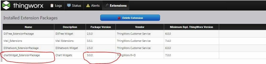

I am also getting same Error while using timeserise chart custom widget, which I have downloaded from PTC marketplace.
Error
09:59:04 ERROR - TW.Runtime.Workspace.Mashups.getWidget exception loading widget { name: Error, message: timeSeriesChartV2doesn't exist }
Tomcat version: Tomcat 8.5
Thingworx version:  ThingWorx 8.2.1-b140
google chrome version: Version 65.0.3325.181 (Official Build) (64-bit)
same is working fine in Internet Explorer, I am only getting an issue on Google Chrome explorer.
initially, this was work fine on google chrome, but after few minutes it started giving me above mention error.
what I did to solve this issue.
follow all the instruction which is mention in below support article
https://www.ptc.com/en/support/article?n=CS246176
but still, the issue is not resolved.

Hi @kpatel-21 I can't seem to reproduce this. Which extension version are you working with? Would it be possible to share screenshot from the Import / Export > Extensions > Manage ?

i am using version 3.0.0
please check attachment.

Hi @kpatel-21 thanks for adding the screenshot, i still can't reproduce this. Is the behaviour same for you if you'd try to access this from the Incognito Mode of the Chrome?
