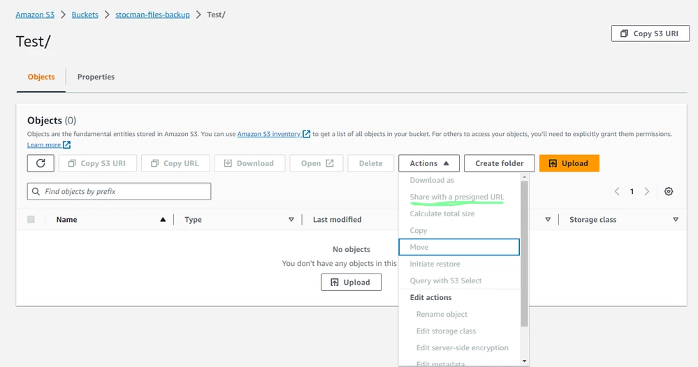

Hi willie
I am trying to create presigned url.But I am not able to create. That option is disabled. Can you suggest any other wayScreenshot 2023-10-10 104242.png
