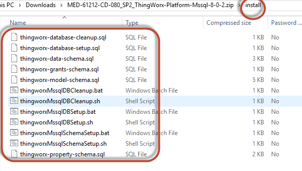

I am facing the same problem while configuring the MS SQL server with Thingworx.

I am trying to configure MS SQL server to thingworx. As per the installation guide it says
" Obtain the database setup script (thingworxMssqlDBSetup.bat) from the ThingWorx software download."
But in the download folder I don't see this file. Can you guide me in getting the required file.

Best answer by supandey
Hi Rashmita, what version of ThingWorx are you working with? All the scripts are under install/update folder, here's screenshot from install folder
