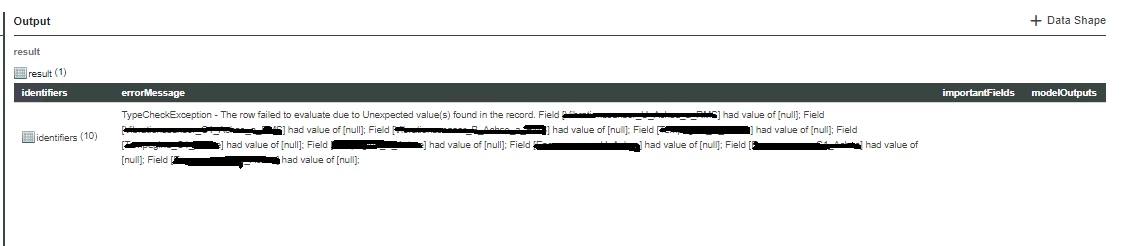

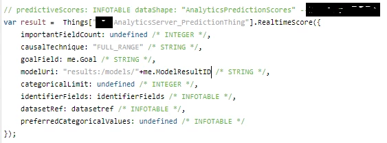

When I use the realtime service under the Analytics_PredictionThing, I see result but when I try to use service on a custom thing,I don't see  result because it fails with this error :
Type Check Exception. The row failed to evaluate due to Unexpected value(s) found in the record.
My release is 8.3.2
Anyone could you help me?
Please find image attachments.
Thank you so much

Given the error message you get it would appear that the dataset sent tot he RealtimeScore service has no value.
I would advise you check the value of datasetref variable being passed to the service
You can find reference to this error in https://www.ptc.com/en/support/article?n=CS284564  - though the article has been written for ThingPredictor, it very much applies to the PredictionThing too.
