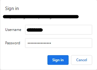

It's not that I should not have access to the composer. It is just strange that for this particular platform, I am "forced" to login using the /FormLogin/ page.
On all other platforms, if I go to the /Composer/ URL, I get the normal "sign in" popup:
I have asked other colleagues and they do not have the same issue when trying to login to this platform...
Is there any settings perhaps that I can look at?
