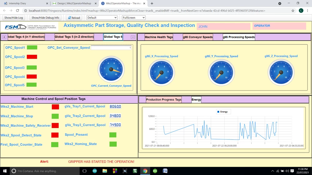

Regarding changing the data of a particular tag using a numeric entry in another tag
In my mashup, I have added two tags, one for displaying current speed of conveyor using the gauge and other for setting the speed manually using a numeric entry. The issue is how can I reflect the change in my current conveyor speed, when a particular speed is entered using the numeric entry.Check the heading global tags 6-> OPC_Set_Conveyor_Speed and OPC_Current_Conveyor_SpeedCheck the heading global tags 6-> OPC_Set_Conveyor_Speed and OPC_Current_Conveyor_Speed

If these are actual tags then you would just be reading the tag values and your set should reflect in a response in your get.
If you are just simulating, then the set would impact the target value for your other tag which is updated/simulated and retrieved with your get.
