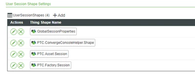

Hi team,
In 8.4 I can see session variable LastAssetChange while creating a mashup. But in 8.5, It is not present. Can someone please let me know where can I find these and what is the specific use of this LastAssetChange variable.

@Bhanu_Manoj ,
Look in the UserManagementSubsystem configuration and check if the UserSessionShapes match between your 8.4 and 8.5 environments.  If not, you can add them to that list.

Hello @Bhanu_Manoj,
Can you please provide more details or a screenshot with the session variable in ThingWorx 8.4 ?

Screenshot in 8.4
in 8.5 we can see only as below.
