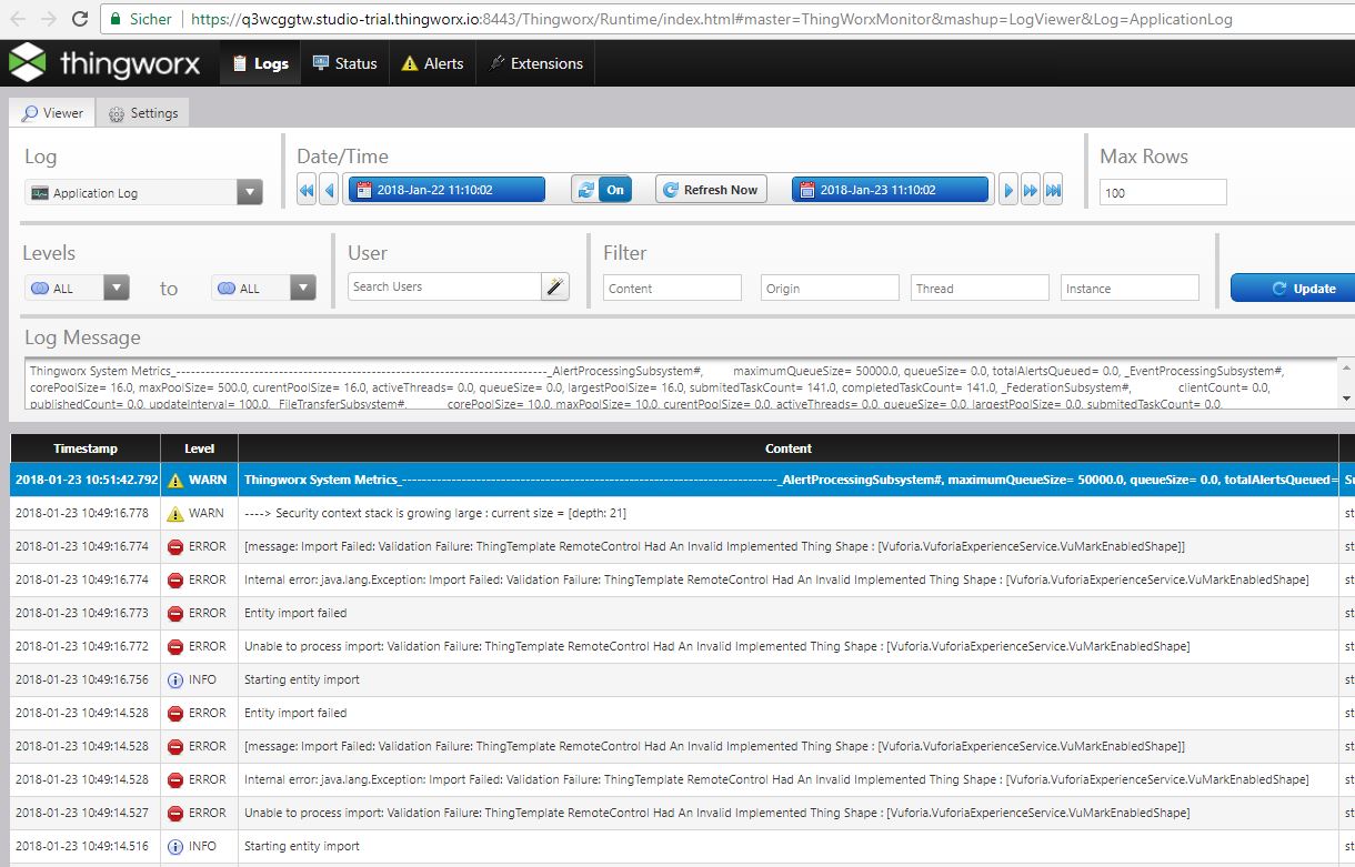

Jan 23, 2018 10:21 AM UTC
I also have the same problem.
Trying to import the provided Entities.xml file from the TV Remote Control Tutorial, as described in the video:
https://www.youtube.com/watch?v=BXbPh7IuTqc&feature=youtu.be   (Time 49:10)
i get the following error:
