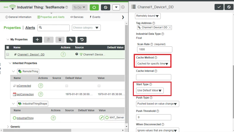

We can create and set remote binding programmatically. But how can we set property attributes such as "Start Type", "Cache Method" and other parameters related to remote property.
I have attached the image for better understanding.

I believe it is part of aspects, try getting the definition and parse out all the aspects.
sorry I had an example of this, but I don't think I have that anywhere anymore because it's on a machine that is now defunct 😞
I also believe others have posted some snippets of their remote binding code, perhaps do a quick search (or even a search through support.ptc.com)
