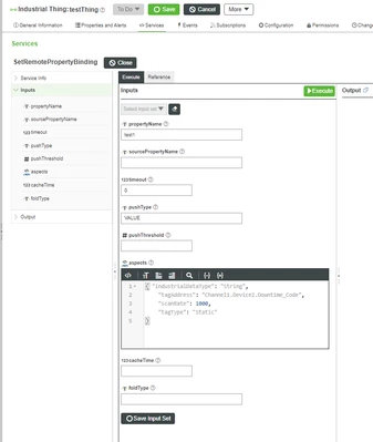

Now I manually create a property from composer called test1 data type string. I also assign IndustrialThing property with the remote thing thing name (used in kepserver)
I then go back to postman and will to bind a tag defined in kepserver to test1 for which I use below URL and body
http://XX.XX.XX.XX:8080/Thingworx/Things/testThing/Services/SetRemotePropertyBinding
"propertyName" : "test1",
"pushType" : "VALUE",
"Aspects" :    { "industrialDataType": "String",
    "tagAddress": "Channel1.Device2.Downtime_Code",
    "scanRate": 1000,
    "tagType": "Static"
Once I run this I get 200OK status in postman but in composer I see the property bound to "test1" and not the tag address .
The values doesn't get transmitted at all, I verified that datatype is string at both the ends. Now If open up composer and run SetRemotePropertyBinding for the testThing. Manually pass the parameter as input to the service and run it, it works fine (see below screenshot)
Can some one Please help me on this?

Hi @slangley
The issue is resolved, I was using Capital "A" for aspect in the postman body it should have been small "a" . No its working. I have informed the PTC support guys who was helping me with the case.
